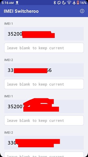

Why does it show dual SIM on F21?
So it can support other devices that have dual sim.
True. But it actually shows me ‘both’ of my IMEI’s.
What does it say by the second one?
Some random IMEI.
And for some reason it shows both twice.

Fixing the double now. Really stupid mistake. As for showing 2 IMEI’s that’s extremely weird. Can you try @ars18 ’s tool and see if ‘read’ also shows 2? I don’t see in what way it can go wrong. Assuming the docs are correct that the test is 0 padded it’s very weird.
Or if you have no patience, can you send me your LD0B_001 file
Edit: while I don’t have a physical f21 to test the app, I tested the Java code in the app on a raw LD0B_001 from a f21 and it only showed 1 IMEI. Can someone else please confirm if it shows 2 IMEI’s by them? The issue of displaying twice will be fixed shortly
@farrict try it now. I fixed the double render and might have fixed the 2 SIM issue. Thanks a ton for reporting the issue!!
