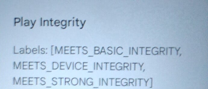

All has already been set up. Valid keybox and fingerprint.
Sign into play store, go to “settings → about” and press check certification status. Should then pass.

Experimental. Let me know if it works for you. When the keybox or fingerprint eventually gets revoked, you will have to set new ones from ksuwebui app.
One thing though. In the pre-rooted ROM, the fingerprint change will make the build back to “user” and you lose pm and adb install. Will say not allowed. Normal APK install is fine.
