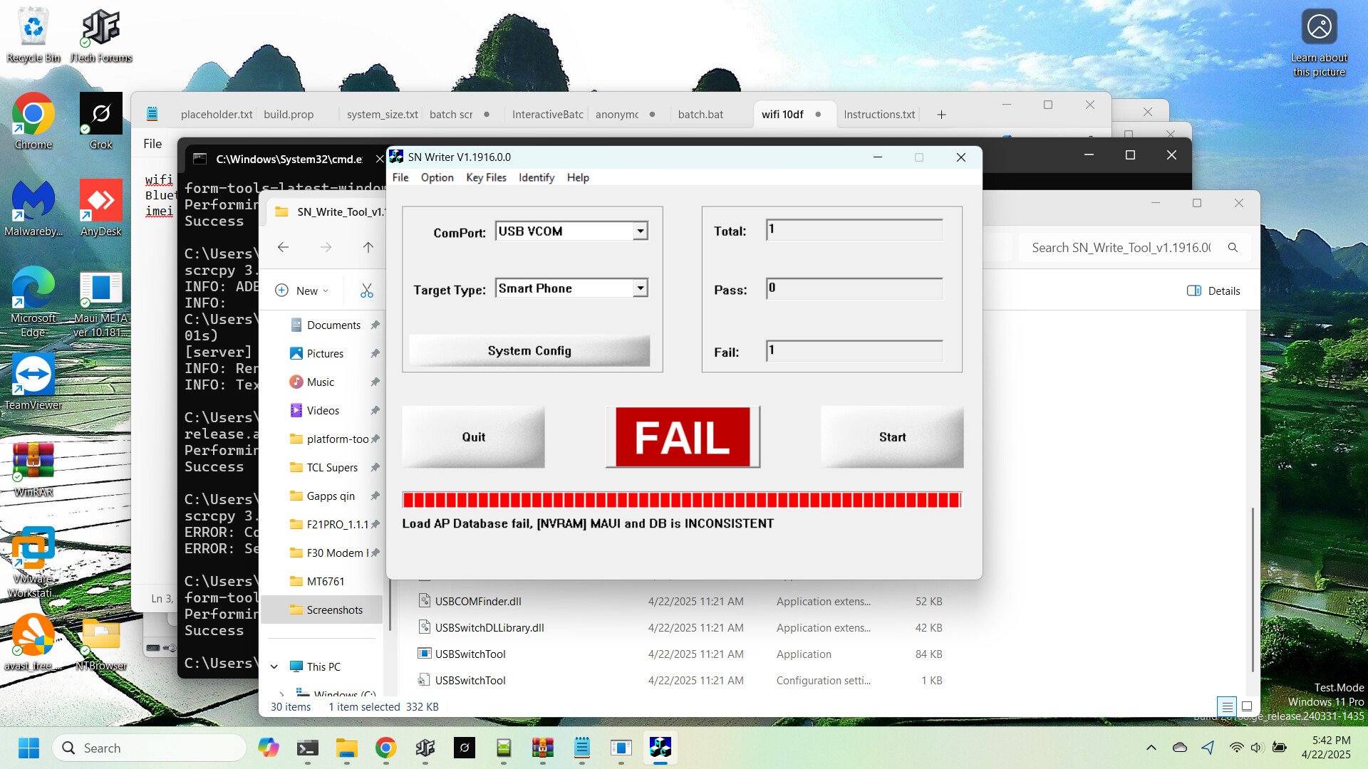

SN Writer Failed on Qin F21 Pro
trying to write imei and wifi and blurtooth and got this error

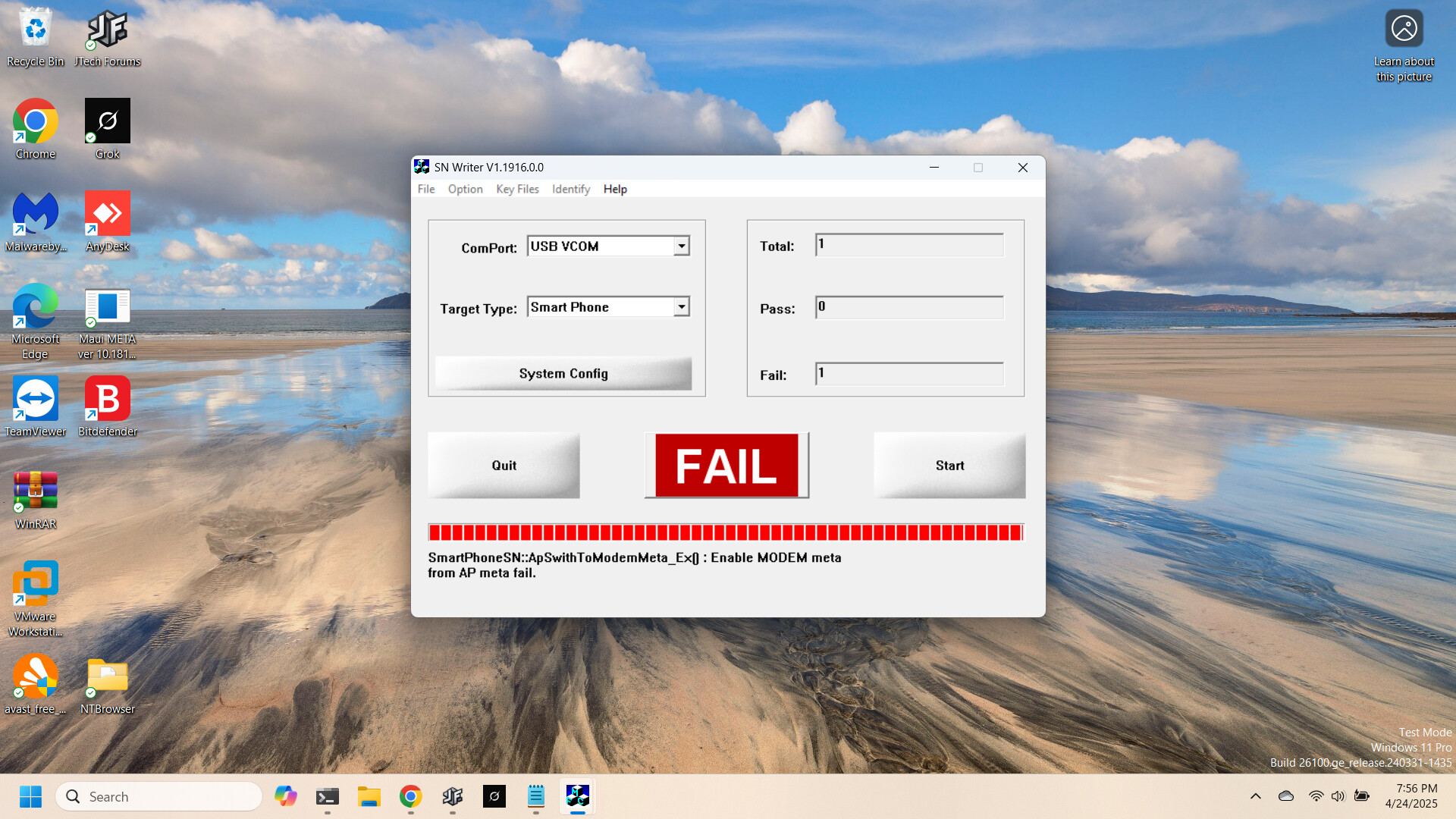

Use Modem Meta, I had this error I was successful with it
doesnt work either it just doesnt load the new numbers says successful but isnt actually
only write imei. only that’s erased by the new partitions. it will say fail, but a imei will go on - a 12345678910 imei.
It says that imei does that work or do i need the real one
both work, but for verizon, you’ll need a reeeeeal one - just a random number other than this 123 number that clearly looks stolen etc.

HELP: running into sn writer issues again
this is after doing that and this is the error i keep getting
tried reflashing the stock then reflashing the 1.1.1 and bands and then sn writer and having this issue

Didn’t help
is there a diference between modem meta and maui meta
Yes. Modem meta actually works…
Snwriter failed. Where do I get modem meta?
Just did this last night.
Can’t say it’s the same for all but sn writer never failed for me after flashing 1.1.1 with sp flash tool.

You can flash that after
