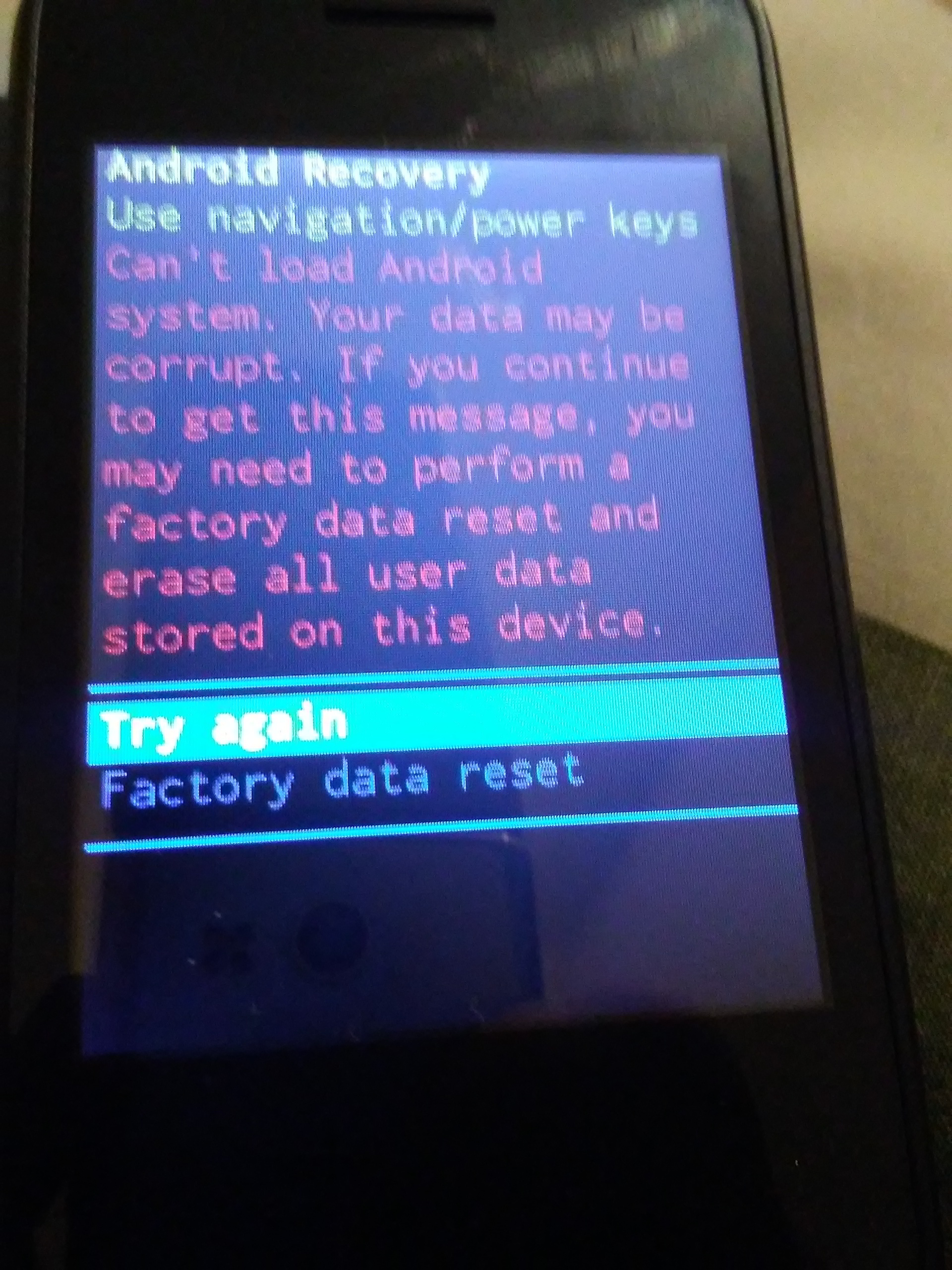

TCL Flip 2 Not Starting
I am on my rooted TCL Flip 2, with play services.
When turning on i get to this screen.
The only thing I did the last few days that may have triggered it is downloading triplesu and enabling speed up device. I also downloaded on whatsapp the option to enable voice notes transcript. The package was around 130 mb.
Anyone can help me?
Do you have a backup of your firmware? If so, reflash with the backup firmware.
In middle of doing that. I am curious to know what caused it though.
Even so, it’s probably not a firmware issue but something you did with root. Now your only option if you want to keep your data is to flash a stock boot image.
If you ever want to root it again, you’ll first have to wipe it.

I just installed @NotABird’s Magisk Module onto a TCL Flip 2 which has MicroG.
After rebooting my phone get’s stuck on the Tracfone screen.
Update: Now I am getting the Secure Boot Failure (I tried disabling vbmeta with the regular ones and the empty one and neither helped).
Had you ever disabled the vb partitions before?
Custom recovery?
It doesn’t work to flash the vb partitions or after flashing it doesn’t help?
I disabled the VB before.
I think I have @neutronscott’s custom recovery.
Update:
I went to recovery and pressed try again and the phone turned on. I am not sure what caused that.
This is what I did while the phone wasn’t restarting. I disabled VB using the empty one. Didn’t help. I disabled using the regular one. Didn’t help. Went to recovery pressed try again and it worked.
