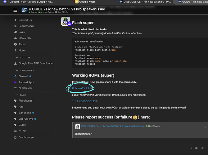

Sorry - realized I wasn’t clear about what super I flashed. I flashed the F21-pro-33.2.1 super that you linked. Audio worked great. Only issue I’m running into is that I don’t have IMS registered. Seems there is something about how the IMS registration is set up in the A.I.V ROM and LineageOS Roms that seems to successfully trigger IMS registration. Any insights greatly appreciated. Also understand you don’t have this phone to experiment with, so totally understand if not any clear answers. Thx!!
Do you have a backup of what was working before? You can just patch that to fix the speaker.
Edit: I understand now what you’re saying, but I still in general really do not recommend 33.2.1, rather to patch any existing ROM u like.

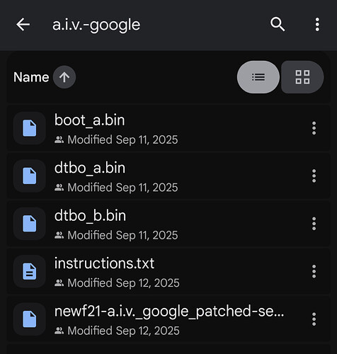

Got it. Thx! And yes, I do have a copy of the ROM that is working here:
But I am such a noob that I am having difficulty re-packing the Super with audio fix.
Do you have any tools that you recommend? Do I have to do this in Linux or any more automated solutions?
Thx much!
So you want full A.I.V ROM, no dumberos?
You can patch fully on device with root, if you don’t want to stay rooted you can unroot after.
Edit - seems like I already did everything
Has all needed partitions
Oh wow! I was looking right past that super! I have it flashing now. Thank you!
