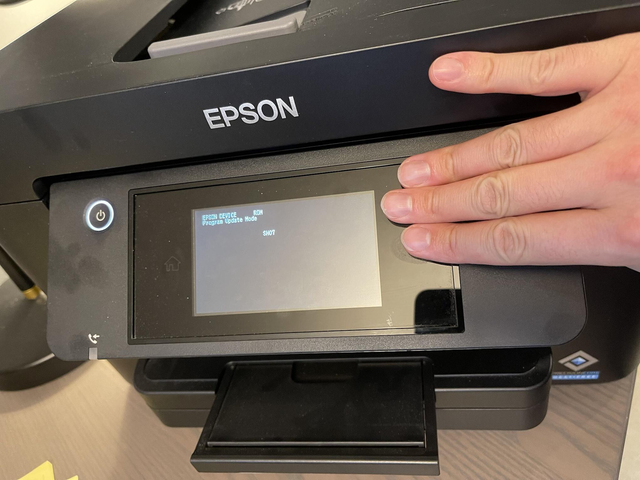

I tried the 3 finger reset but either it didn’t work for me or the power wouldn’t come on. Did Epson maybe put a bug in one of their updates to prevent using this 3 finger reset to work…? I had used the update perhaps 2-3 times since I’ve bought this WF-4820 two years ago. I’ve stopped updating the software after that…
It can be tricky to get the 3 finger reset tight. I would try it a bunch more times.
Any idea where we can find the firmware version for Mac? Epson is sending everyone on a wild goose chase.
*Press: [ 4 ]+ [ 7 ] + [ Job / Status ] + [ POWER ]
By putting my thumb here, I was successful 3 times in a row.
After the December update the thumb in the left corner of the blue part works, but… you have to hold it for like 25 seconds. You know you are right if the printer doesn’t startup when pressing the power button for 3 to 4 seconds, then just keep holding it, of it does start up in 4 secs it’ll go to the homescreen. Good luck you all
I heard elsewhere, that you just need to cover the “?” symbol in the black part of the screen. You can see it even when the printer is off if you look at an angle. This worked for me.
The solution by @rewaren worked for me to gain access, but unfortunately the update via USB kept failing. It would say it finished, but the status light would just flash which indicated failure and never restarted. Verified when I tried a restart via cord power cycle and the crappy update was still present.
Oh well…
Literally just used this today. Not all heroes wear capes…:smiling_face_with_tear:

Thanks ars18 - I used your RJ1018.exe firmware on my Epson XP-355 and worked a treat - now accepts third party ink cartridges as before. Have also disabled automatic updates.
After a few tries with combination of buttons on front of printer, the ROM dialogue box came up on the screen and I then installed the previously downloaded RJ1018.exe file. At first it wouldn’t accept ink cartridges, so I removed cartridges, switched printer off and reinstallled them and all now working fine - just as before - warns you that cartridges not genuine but allows you to continue. That option was remeoved with a recent automatic update. Anyway, learnt much this week. Well recommended. Thanks again - Genius!!
