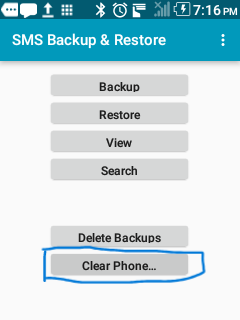

Step 2: Create a Backup
  1. Open the app on your source phone.
  2. Select the Backup option.
  3. Choose the items you wish to back up: Messages and Call History.
  4. Once the backup is complete, you will find a new folder labeled SMS Backup Restore on your phone containing two XML files: Calls Backup.xml and SMS Backup.xml.

Step 5: Restore the Data
  1. Navigate to the transferred call history XML file (Calls Backup.xml) and select it. This should automatically open the SMS Backup Restore app and prompt you to restore your call history. No additional permissions are required for this step.
  2. Next, select the SMS XML file (SMS Backup.xml). You may be prompted to set the SMS Backup Restore app as the default SMS application. If prompted, simply select OK to proceed.
