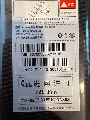

P.S. I heard theres different versions of the phone, I dont know anything about it, if anyone can let me know how to check (without booting up obviously) please do so. The manufacturer sticker is still on back so that might help:

You can flash full as you have the IMEI because of label on the back

Someone said something about a blue or red charging port rim for new and old version
It’s probably the old version based on the serial number
