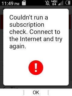

I have visible and when I try to turn on the hotspot it just shuts right off, (after failing to get a “subscription”) anyone have a solution to this

This is a screenshot of the error I’m getting
