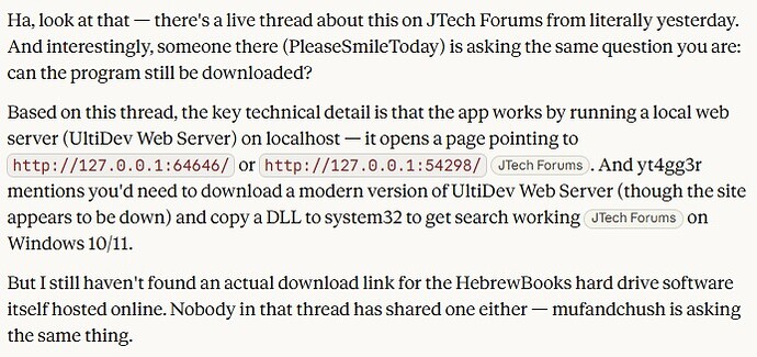

You will need to download a modern version of the server they use, I don’t have the details at the moment, and set up your own batch to use it to run the web app. But you also need to copy a dll to system32 to get search to work
UltiDev Web Server but it looks like the site is down, you’ll have to find it archived
Anywhere I could get this? Could you share the content? What format is it saved in?
Got this from my friend Claude, I am assuming that it will need to be through Microsoft edge with internet explorer mode

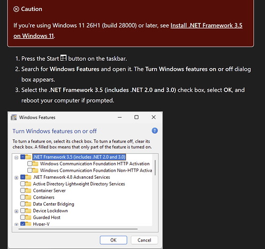

@BenTorah thanks. once i activated .net 3.5 from windows features it works if you open it from within the program you linked.
2 further questions:
  1. when you activate .net 3.5 it needs to download the needed files from windows. ANy idea where I can get the said files for an offline instialtion?
  2. maybe this is beyond my tech ability, but how would I set it up so that I can get it to work with a single double click as opposed to the more lengthy proccess openign it through the progrma you linked?
