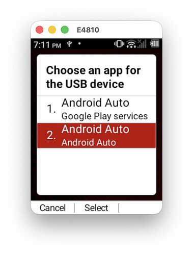

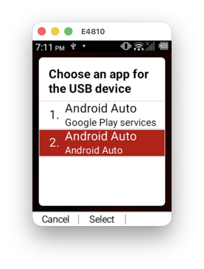

Originally I was just spoofing system framework. When I tried spoofing all google apps, that actually resulted in the described “select app” screen being shown,
but beyond that the flow was identical and resulted in the same error (I still can't install the AA4CAT module after the gApps one or it won't even get to that screen).

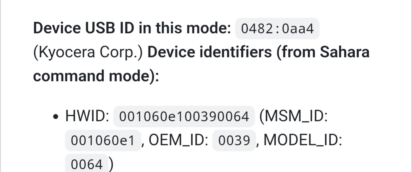

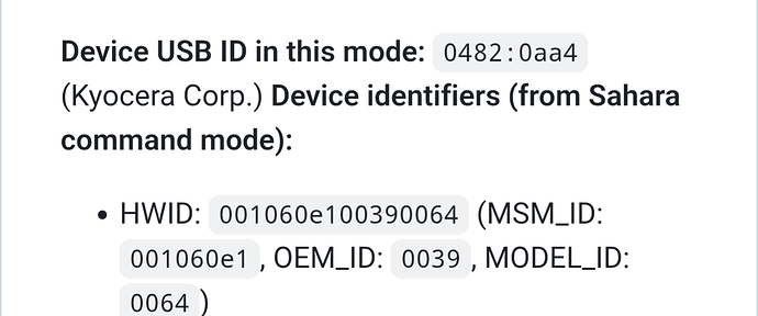

Hey guys, I accidentally flashed a wrong file to the aboot partition of my E4810. Now, after inserting the microSD card with the file shared in the forum and then putting the battery in, the phone shows a green LED. When plugged into my computer, it appears as a device called “KYOCERA_Android” with the hardware ID “USB\VID_0482&PID_0AA4&REV_0100”. What should I do now to get into 9008 mode, or should I just throw this phone away? XD

Take out the battery, keep the microsd in, turn it on and plug it in.
See if you see the below:

This the same actually
It’s funny, normally ppl only brick with bl still accessible, you went further :slight_smile:

After updating Play Services, plug the phone into a car. You should get a prompt asking you to choose an app to launch, select Android Auto, not Google Play Services. After that you should see a screen that says “Android Auto is available in this car”. There might not be any visible button — just scroll down to the bottom and press. That should start downloading and installing Android Auto.
