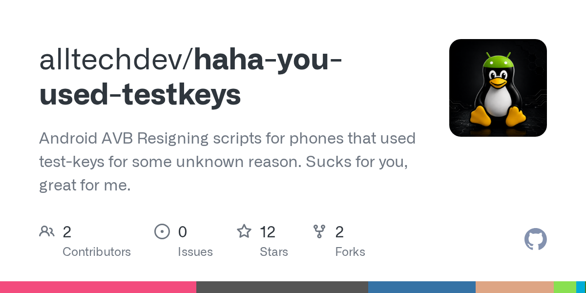

Consider this a PREVIEW, everything is at your own risk. Needs some cleaning up and more scrutiny.
Please test.
Here’s an example of what you can make:
Please test.

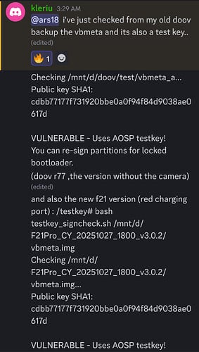

I only tested with the v1 f21 firmware.
There is a check script, so you can verify before starting the process.
Also, this whole thing in general can kinda be forked into a crb like tool for Linux (yes, I know crb is already technically Linux based).
Haha q25 vulnerable too
It seems from this not like that:
https://forums.jtechforums.org/t/qin-f25/3054/43?u=kosherboy
That was on the f25 thread, I’m talking about zinwa q25.
