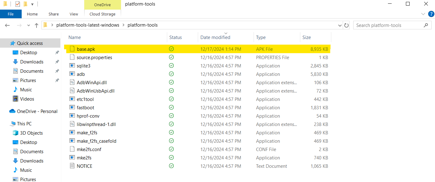

Ok, so after a few attempts, i managed to pull the file. This is what i did.
Using “Windows PowerShell” as i needed to save the APK I’m pulling, as WebAbd will not work for this.
I installed the weather app just to test it. So I’ll be using that package name in my demo.
Enabled USB debugging on my device.
Then ran in the PowerShell window, ./adb.exe devices “allowed the connection on my device”. Ran ./adb.exe shell pm list packages to find desired app. in my case it was com.android.cts.weather, then ran ./adb.exe shell pm path com.android.cts.weather to get the full file path. Which was,
package:/data/app/com.android.cts.weather-1/base.apk
Then Ran ./adb.exe pull /data/app/com.android.cts.weather-1/base.apk Which downloaded the file to my platform tools folder.
/data/app/com.android.cts.weather-1/base.apk: 1 file pulled, 0 skipped. 1.9 MB/s (9149236 bytes in 4.698s)
