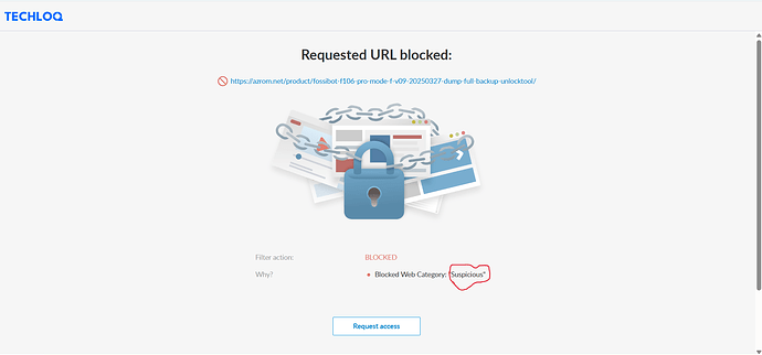

I’m recalling now, I could not locate a firmware dump of the FOSSiBOT F101 non-Pro version (with MANY global bands unlocked), since it was widely superseded by the FOSSiBOT F101 Pro (P22 instead of A22 processor).
The only place I could find it for sale was here but they won’t ship to the US.
If you’d like to give it a shot and have it delivered somehow, this might work. Would have to verify the bands in EM, dump the partitions, and flash to Qin.

looks like your not the only one who says sketchy
Googled a bit, the site doesn’t sound too trustworthy.
