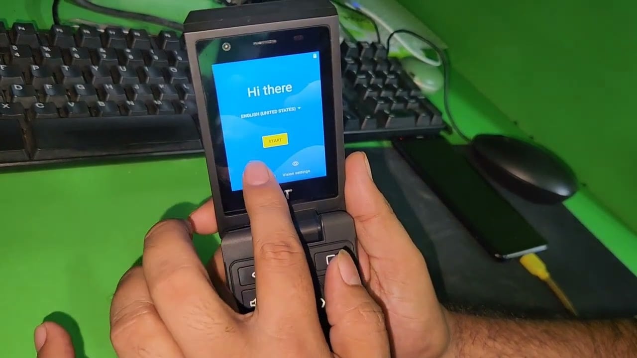

ive had a cat with a frp lock, Though you can use the offline hack to get around it (Back clicking a bunch of times )
All you have to do for a CAT S22 to get out of google frp is get to settings apps and disable play services and then run the regular setup then re-enable Play services
Take a look at Bypassing Frp on Pixel 3 (android 9) to bypass frp
This is for a pixel 3 should work on other phones as well
Here’s a video explaining how to do it
Nice Video! different method that i used keep in mind that sometimes google patches it
