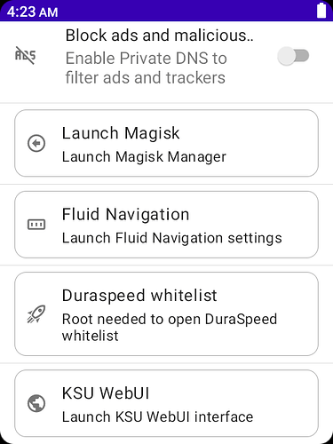

Updates to rooted ROM
  • FNG built into system
  • No weird screen on launcher (when swiping right on home screen)
CREDITS @KosherFlipper - The launcher checks to see if ro.product.name contains “gms”. If yes, it does not show the screen when swiping right.
