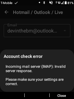

Now what?
I never did it with outlook i only did it with gmail and with gmailYou have to log in your email with a browser and then uninstall the browser and it will stay logged in could be its the same with outlook not sure never used it

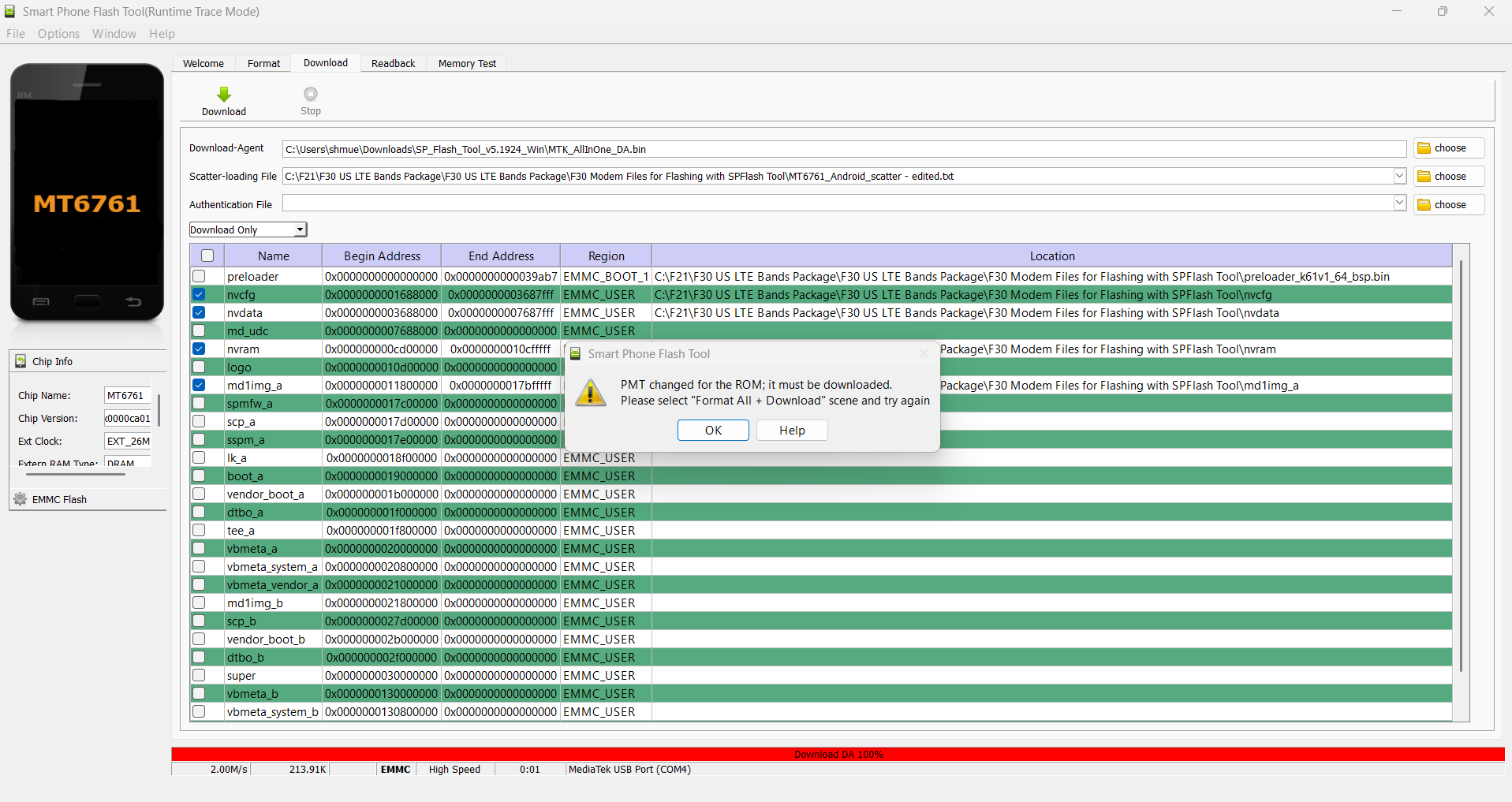

Anyone know what this error means on sp flash tool
I logged in with a browser, this is what it showed after the browser window closed and it tried connecting to my account.
I get this error when i try flashing the US bands on a qin f21 (I’m running TripleU’s rom)
I was able to flash it via Fastboot

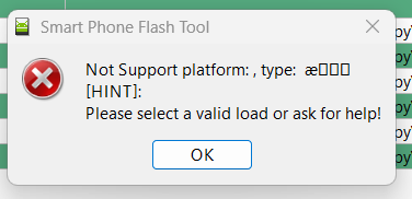

I got the following error when trying to write the IMEI of a qin f21
Load AP Database fail, [NVRAM] MAUI and DB is INCONSISTENT
I’m following the standard directions to unlock bands
Use modem meta a great alternative
it’s ok. the IMEI worked, but its 1234567891011 etc.
basic problem…
i recommend everyone the infinity CM2 Dongle
What is infinity cm2 dongle?
google search
Why would that help?
it doesn’t use meta mode…
And what’s wrong with meta mode?
meta mode is messed up by a lot of ā€œheimishehā€ phones such as the f21 , f22 etc.
i never liked how it worked.
modem meta is good, but takes 10 minutes and can also stay stuck by 87% from time to time…
so doing it from a brom method and not a meta method - automatically results in 100% success each time.
Can you share the files and I’ll just put it on a USB
(Will that work ?)
:joy:
I don’t know about you but by me modem meta takes Max 2 minutes
Ok. Good for you. and? you know how much times meta mode makes problems? plus, CM2 takes about 5 seconds
