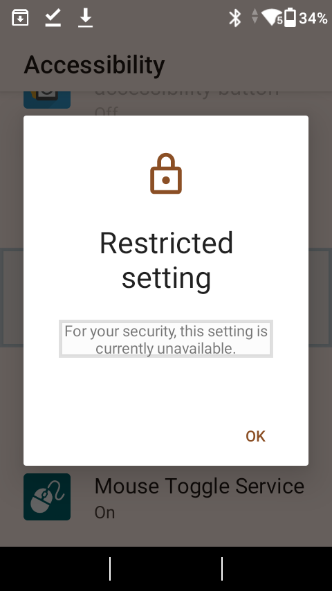

I have a Sonim x320 (Xp3Plus 5G), - yes, I’m in middle of writing up a review, will post as soon as done - and I can’t enable accessibility on it for @wheredidmysleepgo’s C9 and @sh7411usa’s
Pointer apps.
When I go to accessibility settings to enable it, those two apps are grayed-out.
I haven’t either been able to enable developer options on it.
When I tap on build number, nothing happens.
Any suggestions?

Turns out that it’s caused by Android 14’s tighter security.
Google AI overviews:
In Android 14, accessibility features, especially for apps, may be restricted due to new security measures. This can prevent apps from accessing certain accessibility features or data. To enable accessibility access, you may need to explicitly allow restricted settings for the specific app in the app’s settings or within the accessibility settings.

Navigate to Settings: Open the Settings app on your Android 14 device.
Go to Apps: Find and tap on “Apps” or “App info”.
Select the App: Choose the specific app you want to grant accessibility access to.
Access More Options: Look for a three-dot menu (or “More” option) in the app’s settings.
Allow Restricted Settings: Select the option to “Allow restricted settings”.
Follow Prompts: You may need to confirm your choice with a PIN, fingerprint, or other security method.
Go Back to Accessibility: Navigate back to the Accessibility settings and enable the desired accessibility feature for the app.
Troubleshooting:
Trigger the Restricted Setting Dialog:
If the three-dot menu is missing, you might need to first trigger the “Restricted setting” dialog and click “OK” before going back to the app’s settings to allow access.
