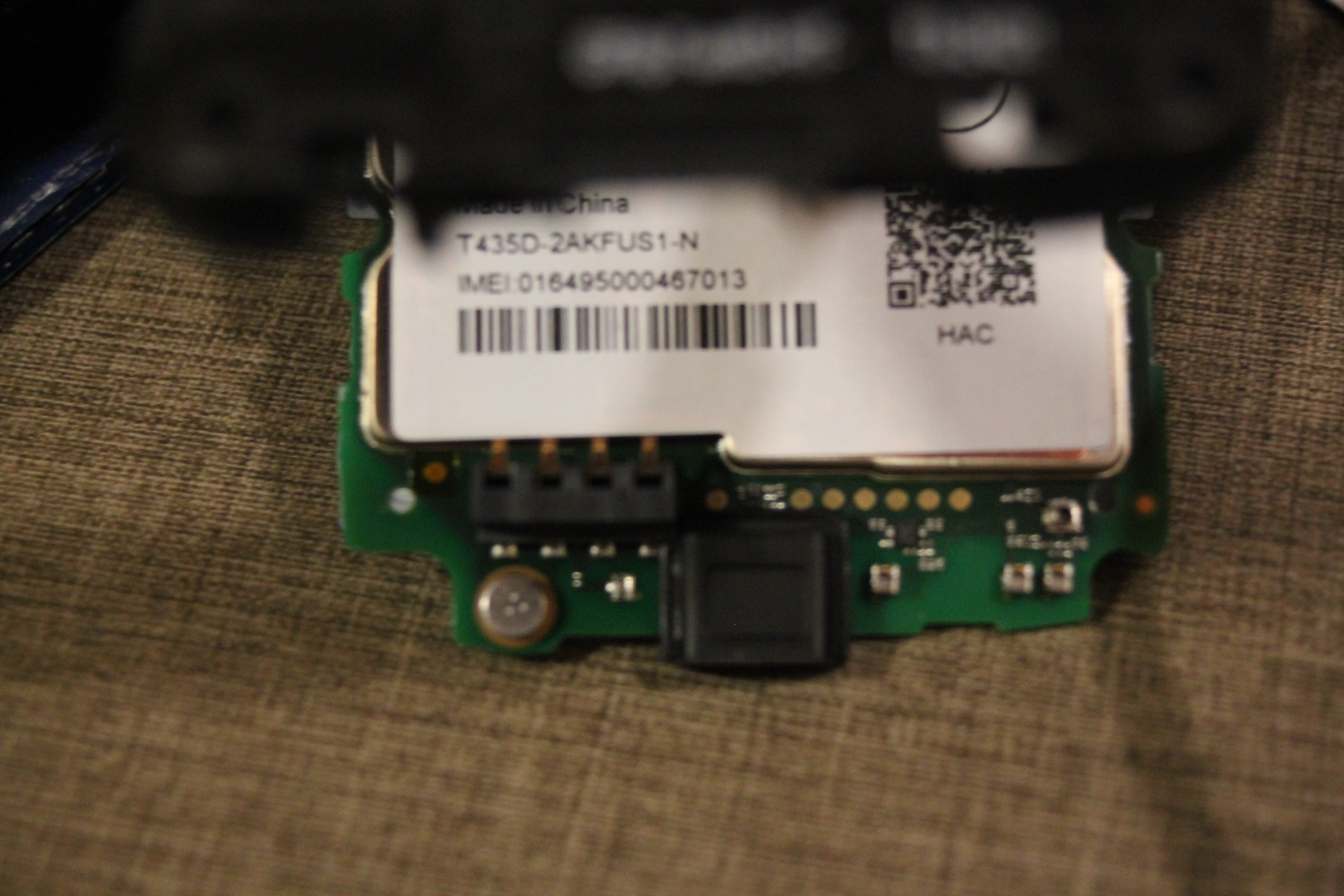

I’ve often heard that you can dump device firmware via jtag, but haven’t ever done it. Can anyone confirm for me if the six pins in a row in this picture look like a jtag interface?
Ask chatgpt
Aaaah… :fearful:
That’s high tech for me…
What’s jtag
