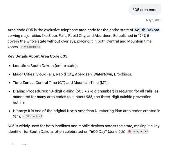

Why are a lot of hotlines and conference number with a 605 area code?
Disclaimer: This was NOT written by AI, feel free to read.
Why do many of the free hotline numbers use a 605 phone number instead of a local number?
When you place a call with your phone, the call goes thru internet lines placed by companies around the region. Whenever you make a call it uses those companies wires, the company charges a minimal fee, usually fractions of a penny for cities. But in rural the companies that put all wires have a high cost for putting up wires over many miles and there is less customers that pay for it. So the fcc allows them to charge much more per call, a few cents per minute, so that they can make up for it.
So the way it works is that if you create a number with such an area code, then the call gets routed over these expensive lines, And every minute that someone is on the phone with this number the carrier makes a lot of money on it from the users phone company. They then give a kickback for the hotline owner for getting them the call. You never see the charge because your phone provider pays it. The more people spend on the phone with these hotlines, the more money the hotline owner makes.

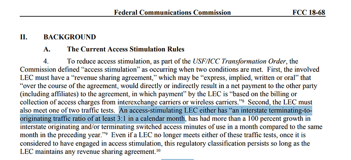

Worth noting that sinc around 2019 the FCC started cracking down and made a rule that if you have more than 3 incoming calls to outgoing calls (a 3:1 ratio), then the carrier must pay for it…
https://docs.fcc.gov/public/attachments/FCC-18-68A1.pdf
Page 3
There are further proceedings underway at the FCC to fully restructure telecom billing to make traffic pumping like this entirely unprofitable.

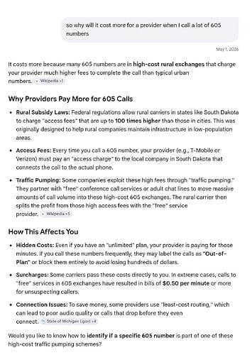

What happens if I have a local number and I dial *72605… So my number gets forwarded to that 605 number who pays the call?
Both, you can test it with a minute plan when you forward a number both lines use up minutes, and each time you call anyone even when not forwarded you both use up minutes
Scroll down Google search AI
I did notice once that google voice would want ~1c/minute to call a 605 hotline number.

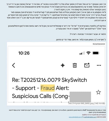

The real question is how do any of us get in it; meaning setting up our own free/profitable hotlines.
https://www.ivelt.com/forum/viewtopic.php?p=6413943#p6413943
Interesting to know that this person is building a full crm now.
You can see more at Skytek Desk – SkytekTel
He used to have pictures of it, but it doesn’t show images now.
