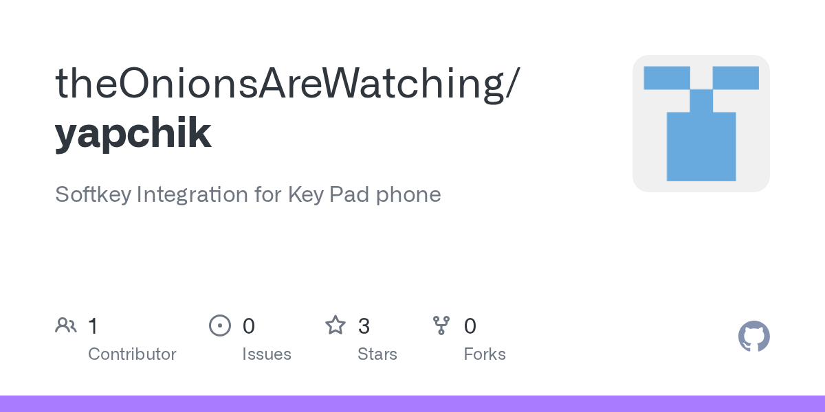

Yapchik: dumbphone UI integration for Android apps

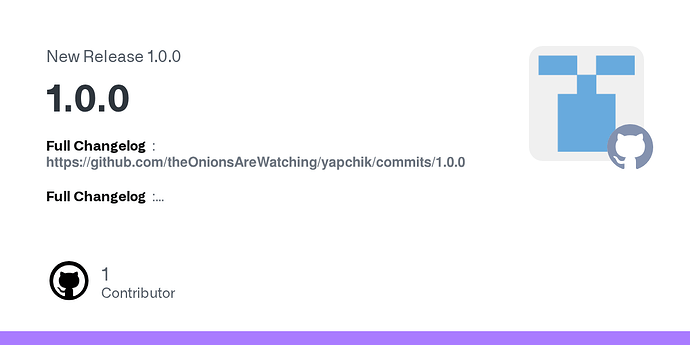

here are 3 test apps with all 3 themes, it has demo screens and a toast popup whenever a softkey is pressed
the pareve yapchik is ready
