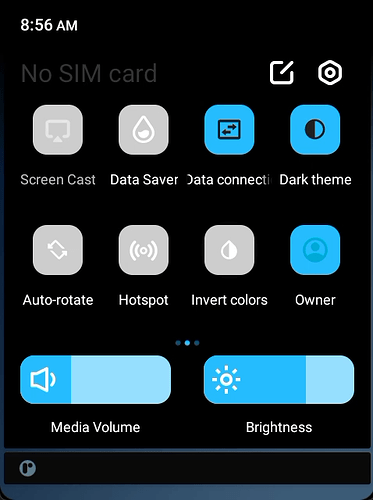

  1. It supports @ars18’s fix adding the hotspot QS tile back into the ROM (mirrored here).
  2. It supports many other QS tiles - including dark theme toggle, based on שניאור שמח’s guide on mitmachim (although I used apktool instead of MT Manager - so I get a drop of credit for being a teeny wee bit more manual) - related to above.

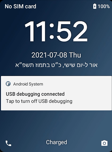

To turn on Hebrew Date on the Lockscreen:
adb shell settings put global show_hebrew_date_on_lockscreen 1
To Turn it off:
adb shell settings put global show_hebrew_date_on_lockscreen 0

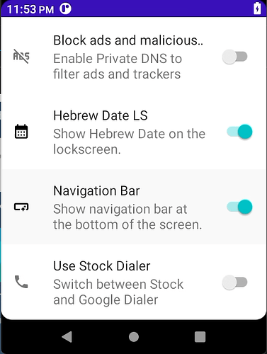

UPDATE Extra Settings 1.2 (2) - here is an updated version of “extra settings” which offers a UI toggle for turning hebrew date on and off. It also allows toggling navigation bar on the bottom of the screen on and off.
(Credit to יצחק.א on Mitmachim for his guide on enabling the navigation bar. Credit to gemini for writing the toggle.)
I sincerely hope to address the UI quirks with the navigation bar (update - done here), and to make the icons in extra settings compatible with dark theme (update - done here). But for tonight, it’s waaaay past bedtime.

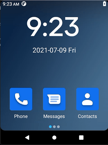

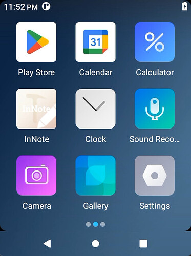

Btw, the navigation bar is provided even though I personally think it looks awful. Also, it doesn’t really “shtim” with dark theme (which is why all the pictures in the post are in light theme) because somehow you can see behind it when scrolling. I can try to find the elements in System UI and fix it, but its not a high priority.
I actually use navigation on the qin like this: The owl key is mapped to home using key mapper, whereas the back button functions natively as… well, a back button. Also, longpressing the back button brings up the recents screen natively. So there you go - physical 3 button navigation using only one keymap and you don’t need FNG (which I found supremely annoying) or an on screen navigation bar that hogs precious real estate in an already limited environment.

  • Added dataconnection tile to values/strings.xml (Key quick_settings_tiles_stock) based on actual supported tiles listed in com.android.systemui.qs.tileimpl.QSFactoryImpl.java. Incidentally, discovered that reverse, alarm, mictoggle, and reduce_brightness (included in the Mitmachim guide) are not supported by 6.1.3.

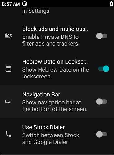

  • Fixed icon drawables for compatibility with dark theme.
  • Changed Hebrew Date preference title.

  • Fixed navigation bar optics for dark and light theme.
