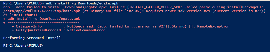

and via powershell i get
adb : adb: failed to install Downloads/egate.apk: Failure [INSTALL_FAILED_OLDER_SDK: Failed parse during installPackageLI:
/data/app/vmdl301747773.tmp/base.apk (at Binary XML file line #7): Requires newer sdk version #29 (current version is #27)]
At line:1 char:1
  • adb install -g Downloads/egate.apk
  •   + CategoryInfo          : NotSpecified: (adb: failed to ...ersion is #27)]:String) [], RemoteException
      + FullyQualifiedErrorId : NativeCommandError
This is when trying to install on the lg classic

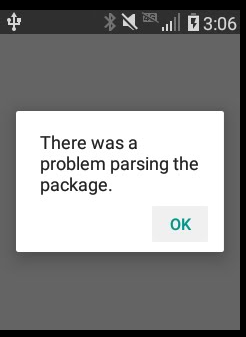

when trying a direct install
Thanks for your feedback. I will see if I can create an alternate download with a different sdk version.

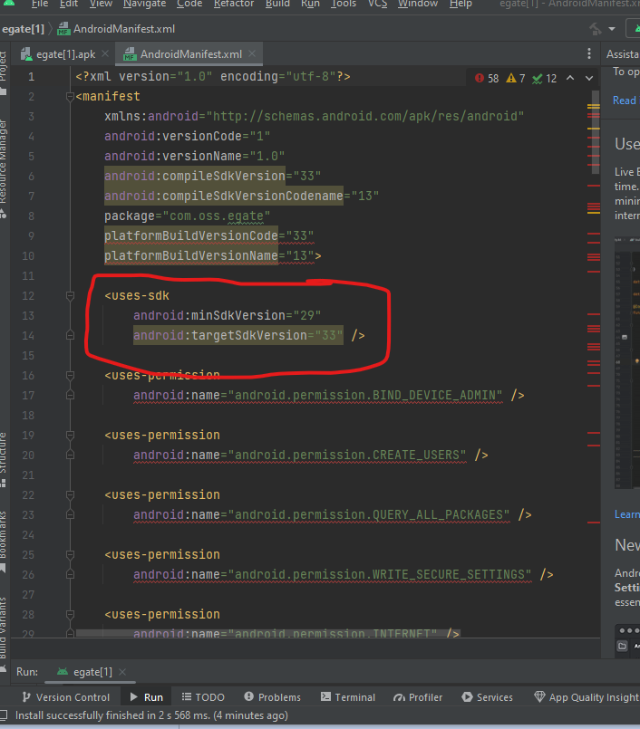

additionally would i be able to do myself via android studio ?
I changed the minSdkVersion to 24. If you use the discount code I gave you, you should be able to check out again and get a download for this update.

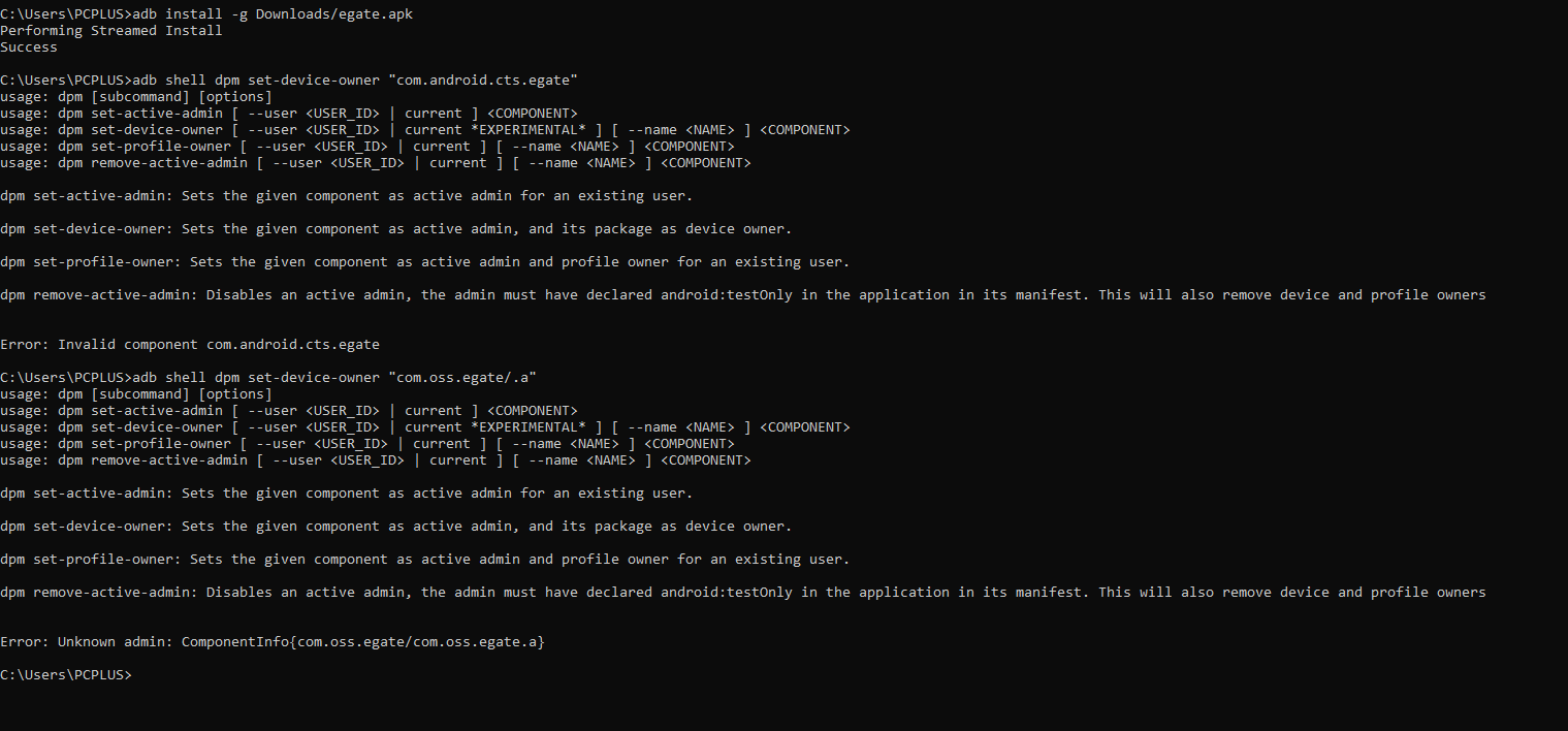

when i run adb shell dpm set-device-owner “com.oss.egate/.a” i get Error: Unknown admin: ComponentInfo{com.oss.egate/com.oss.egate.a}
when i run adb shell dpm set-device-owner com.android.cts.egate i get Error: Invalid component com.android.cts.egate
when i pull tha package name i get package:/data/app/com.android.cts.egate-zuzhZIMwVuo4yM5W7fVUuA==/base.apk=com.android.cts.egate

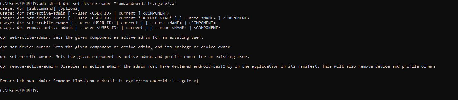

try adb shel dpm set-device-owner "com.android.cts.egate/.a"
didnt work
