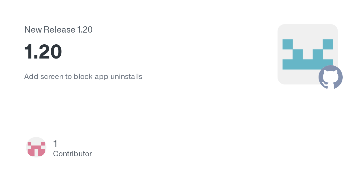

Version 1.20
Adds app names to the app IDs listed in the unhide apps screen.
Also adds new screens to block apps from being uninstalled.

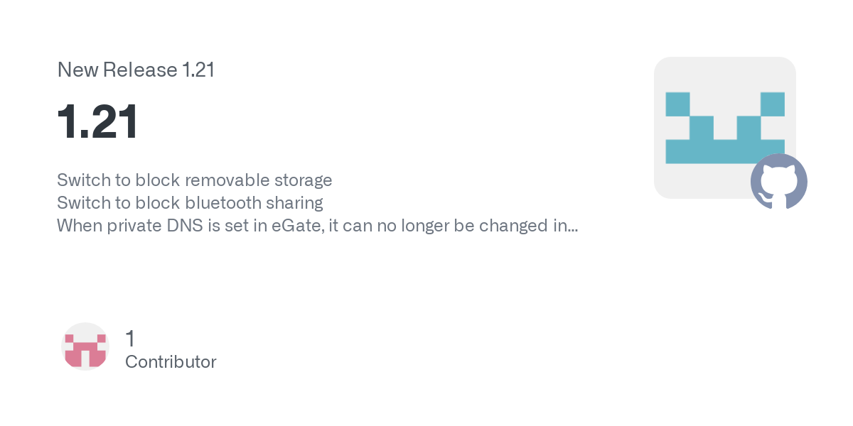

Versioni 1.21 released:
Changes:
Switch to block removable storage
Switch to block bluetooth sharing
When private DNS is set in eGate, it can no longer be changed in settings.
