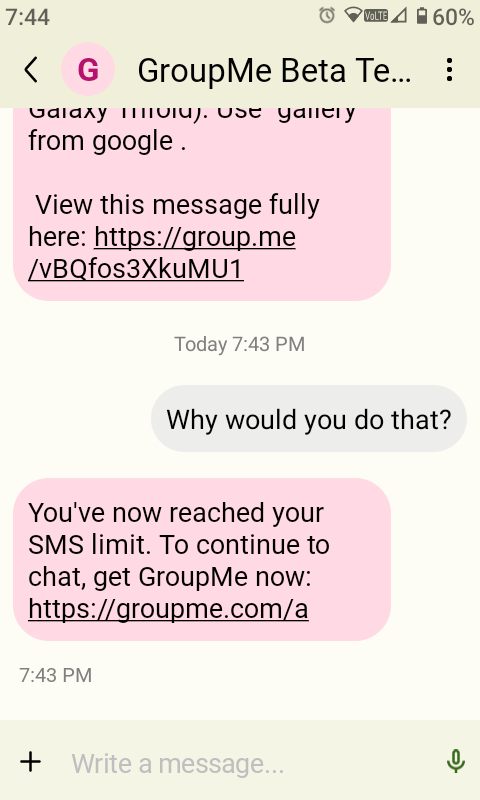

It was fun while it lasted, but it looks like the party’s over, guys.
:open_mouth::open_mouth::sleepy_face::sleepy_face::sob::sob:
What will we do? Who will we true advantage of next?
