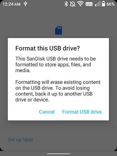

Getting "This USB Drive Needs To Be Formatted" Message
I get this message when connecting a USB to my Qin.
Any way to access my stuff without formatting?

Sorry for not being clear. I can access my stuff on my laptop. I just get the message when putting it in my qin. I dont want to back up 200 gb of stuff to then format it. So I was asking for a different way.
When you connect the card to the computer
A message pops up saying the card needs to be repaired (If not, do it yourself, right-click on the drive, properties, search there and you’ll see)
Click OK and then insert the card into the phone
This will not erase anything from the card
This is what I did last week and it worked

Nothing popped up when I put it in my laptop so I went to properties and pressed scan and repair and it said no issues found.
I tried it in my Qin again and no luck.
Just try changing it to FAT32
You need to remove everything from it first though because this will Erase everything
Tried mixplorer?
Press set up later, open the app, and see if it appears in the side menu.
There’s also this (never tried):
I have another idea, which I think is preferable (with root) but I need to know the filesystem.
Send me output (with USB connected to phone) of
su -c blkid
Then you’d create a mount point, and mount based on filesystem type, just like you’d do on Linux.
