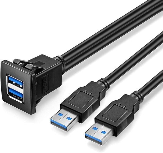

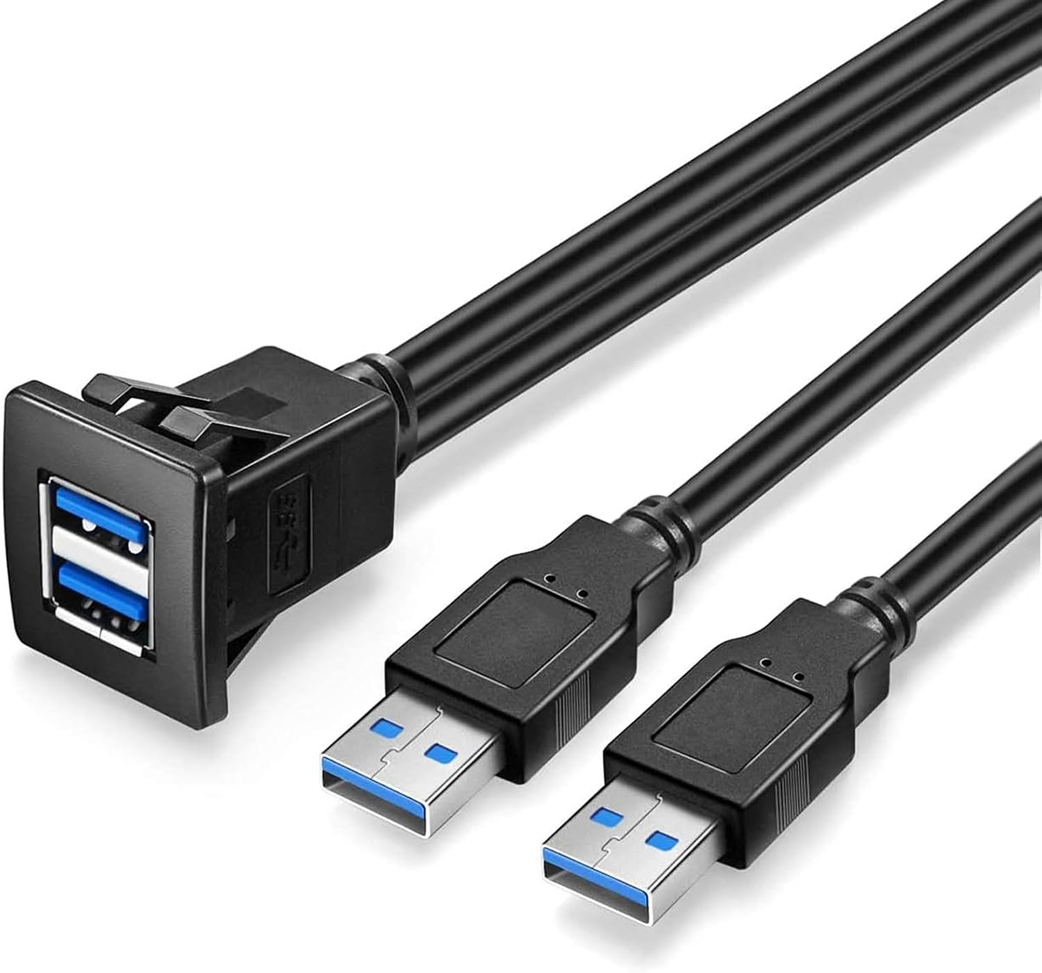

How much would something like this cost to install by a mechanic?
U need USB a to a
Thinking of using something like this. Might even fit in the space of the old USB port and I won’t need to cut anything.

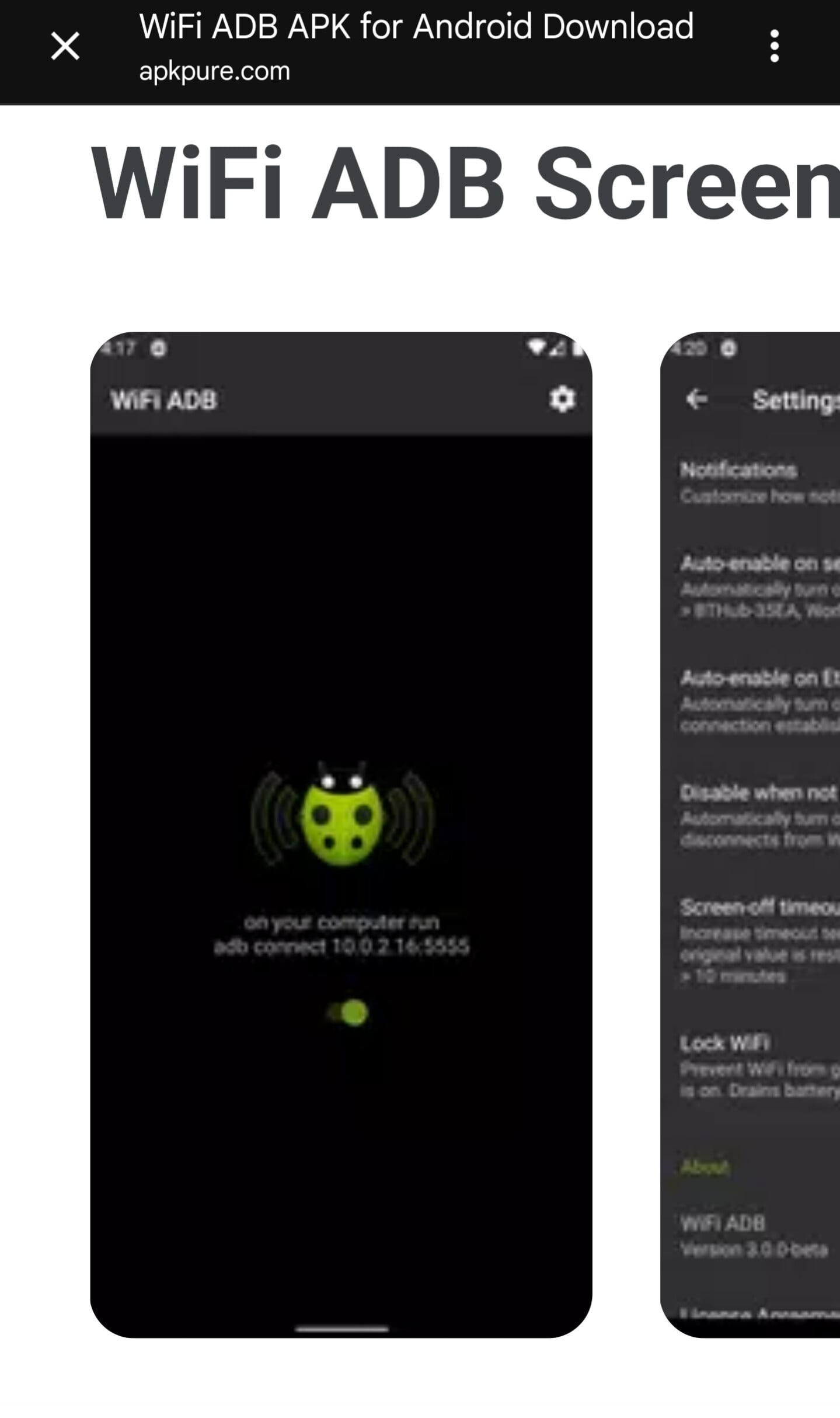

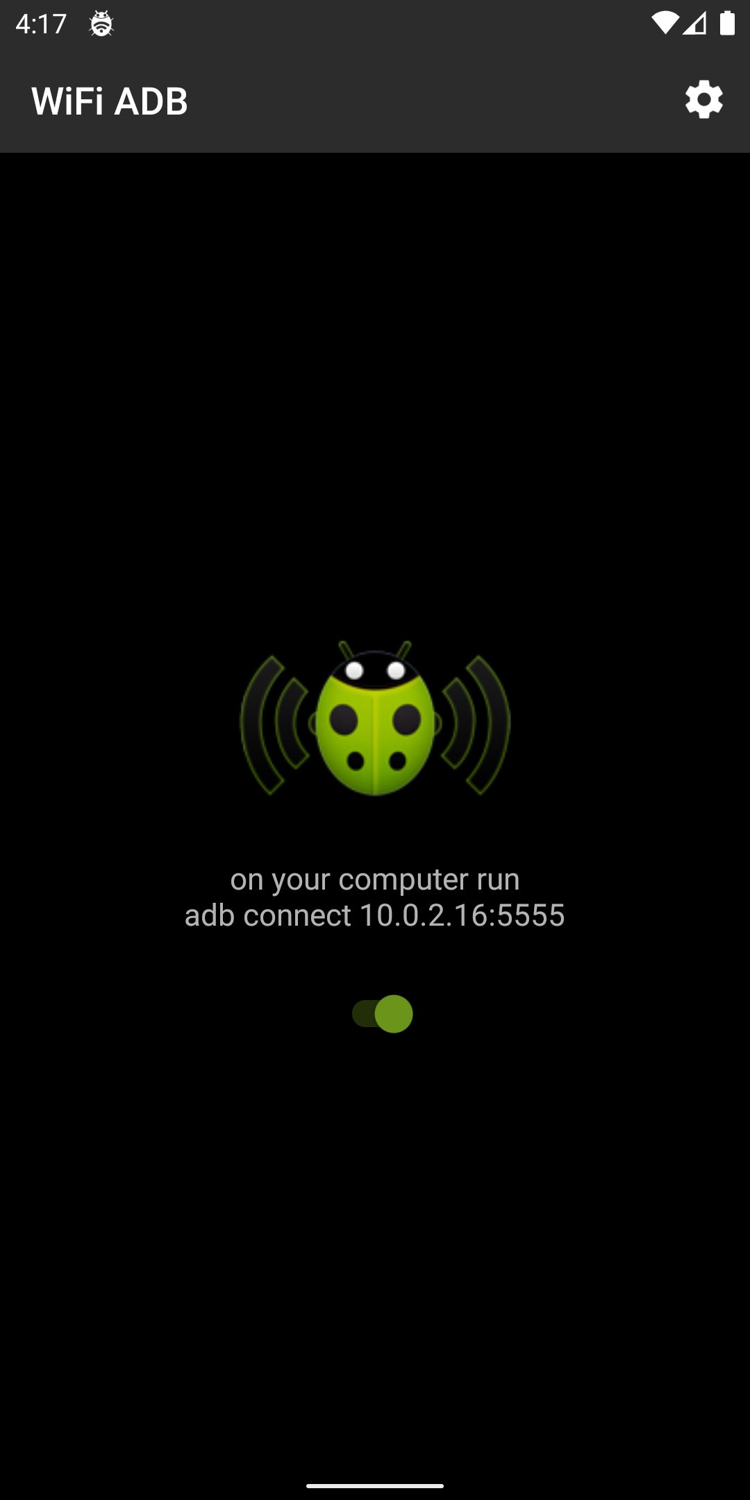

Forgot one thing. Install the wireless adb app I linked in this thread
Edit: here
Not supposed to work without root but it did on 2 headunits so far

Install that apk and tell me if it activates
i already installed it how do i know if it gets root?
The point is not root the point is wireless adb first

The app activated like the screenshot?
The dial Turned on and turned green but it didn’t give a message to connect on my computer.
