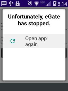

i skipped that step and proceeded with the installation as usual, it allowed me to set a pin but when i try to log in the app crashes
What is the output of adb shell dumpsys account?
My bad. I didn’t test the upload properly. I know what the problem is, and I will upload a fixed version tomorrow. This is a separate problem from the Not allowed to set the device owner error.
