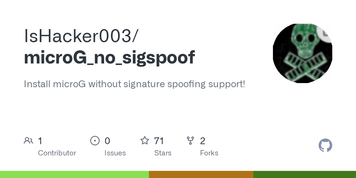

LSPosed is a big security risk.
Use this instead, doesn’t need signature spoofing:
before i go through with setting this up, can you or anyone confirm, is this fundamentally different to the android auto implementation that was done in Darth’s aa-test-rom?
in that rom, it fails to connect to my car and throws a communications error (says something about the time being off sync).
would this work where that fails?
can you explain more (this is what i did should i be scared?)
