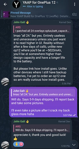

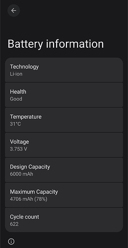

So, I came across the fact that the OnePlus 13 battery is the same size and has pin connectors. BUT it has a lot more juice :slight_smile:
I saw some ppl successfully installed the battery, but what nobody mentions is if they edited the DTBO partition to actually support the new capacity. Don’t believe you get the larger capacity benefits if you don’t.
So, my question is, anybody have experience on Qualcomm with flashing a modified unsigned DTBO on unlocked bl? More security and more prone to failure then MTK or no?
@BenTorah any insight?
It’s time for a new battery anyway and id rather order the 13’s.
Source material links:
https://xdaforums.com/t/oneplus-13-battery-inside-oneplus-12-mod.4739626/
https://www.reddit.com/r/OnePlus12/s/tP1zCOlEFY
https://www.reddit.com/r/OnePlus12/s/YLU3Xc4rkJ

Nice. Gotta find a reputable place to order one.
Update: Ordered! Would be absolutely awesome if all works nicely
Update:
Don’t have the battery yet, but I flashed my modded DTBO to test and we are good!
Reporting 6000!
