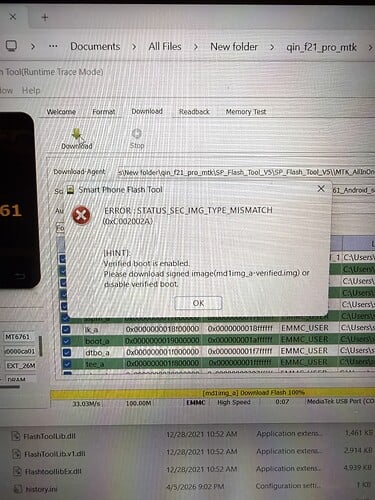

Heres the exact error im reciving:
ERROR: STATUS_SEC_IMG_TYPE_MISMATCH (0xC002002A) [HINT: Verified boot is enabled. Please download signed image(md1img_a-verified.img) or disable verified boot. MT6761 <0000ca01 EXT_26M DRAM к_а boot a atbo_a tee a 33.03M/s FlashToolLib.dil FlashToolLib.v1.dil FlashtoollibEx.dil history.ini
Unlock the bootloader
