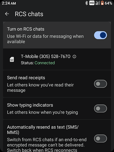

Recently I stopped receiving and being able to send RCS messages. Rooted Qin f21 pro. It still shows RCS connected in settings and whenever I send message it tries to send RCS but fails, message failed to send
