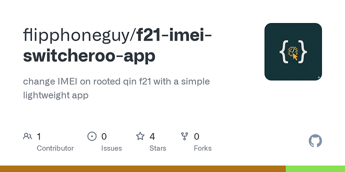

If u don’t care about bt and wifi address, use this app to change IMEI after install:

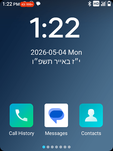

I made a few changes as well I systemized the new IMEI app, hebdate, siddur, removed the notepad added in color note added a toggle for dark theme added search in
settings and Hebrew date under the regular date in the home screen still working on the lock screen
