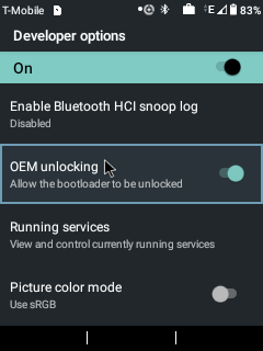

I had no problem getting to fastboot, but the bootloader is locked.
Tried fastboot flashing unlock and fastboot OEM unlock.
Didn’t work.
What r u trying to do?
Did u unlock the bootloader in developer options?
You can’t unlock bootloder just from developers options
He means allowing oem unlocking in developer options.
And yes, I did.

Not sure why you are trying to unlock the bootloader its a qualcom device you need the correct firehose
You’re mixing up two different things.
For EDL, Qualcomm’s version of brom, you need a firehose.
But if you can unlock the bootloader, you can flash using fastboot, and you don’t need any firehose for that.
It won’t work because Sonim locked it and won’t let you unlock it.
There isn’t anything you can do about that.
