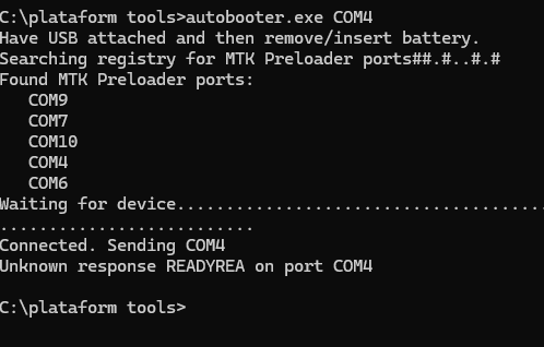

Can anyone help me? I’m trying to flash my TCL Flip. I’m running autobooter.exe with drivers installed, and every time I get another error.

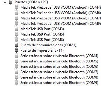

What happens is that it connects, after 2 seconds the USB port disconnects, and after 2 seconds the USB vcom disconnects.
And autobooter detects it, but the cmd closes immediately.

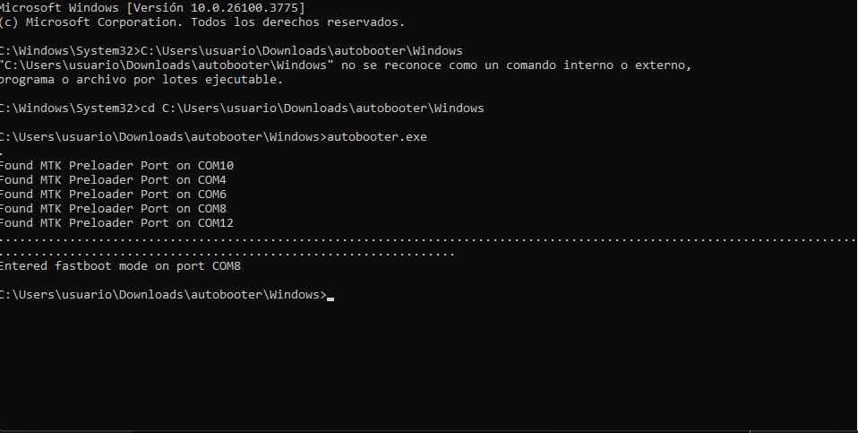

Try running that autobooter in cmd and send a screenshot
just this time he tells me this:
but I don’t see fastboot mode on the phone
