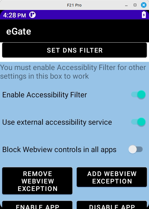

We have solved the Qin F21 Pro problems by supplying a separate app to handle the accessibility filter operations on the F21. As part of this, there is an additional apk file available for download that needs to be installed in addition to the main eGate apk on the F21. On all other devices, no additional apk is needed. Note that all configuration is still done through the main eGate app. There is a new option in the Accessibility section name “Use external accessibility service” that tells eGate to use the additional app.
Because the accessibility filter is now a separate app on the F21, you need to reboot to fully apply configuration changes.

I turned on accessibility and set dns filter but i can still change it at the settings
Can you get me a screenshot of dns settings? It’s possible it is slightly different than on my devices.
