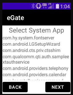

Installing eGate on LG Classic

I installed eGate on the LG classic with a regular APK installer which I don’t think uses the “-g” to install it.
Now when running:
adb shell dpm set-device-owner com.android.cts.egate/.a
I get:
java.lang.IllegalStateException: Not allowed to set the device owner because there are already some accounts on the device
at android.os.Parcel.readException(Parcel.java:2021)
at android.os.Parcel.readException(Parcel.java:1959)
at android.app.admin.IDevicePolicyManager$Stub$Proxy.setDeviceOwner(IDevicePolicyManager.java:5184)
at com.android.commands.dpm.Dpm.runSetDeviceOwner(Dpm.java:148)
at com.android.commands.dpm.Dpm.onRun(Dpm.java:96)
at com.android.internal.os.BaseCommand.run(BaseCommand.java:54)
at com.android.commands.dpm.Dpm.main(Dpm.java:41)
at com.android.internal.os.RuntimeInit.nativeFinishInit(Native Method)
at com.android.internal.os.RuntimeInit.main(RuntimeInit.java:285)
I ran this as well before trying to set the device admin:
adb shell pm uninstall -k --user 0 com.qualcomm.simcontacts
This error shows when you have some accounts set up on the device, perhaps a Gmail or WhatsApp account. Android does not allow setting a device owner when installed apps have accounts set up.

The way I got it to work was by running adb shell dumpsys account which shows the accounts on the device. What I got was:
User UserInfo{0::13}:
Accounts: 2
Account {name=Smartlist, type=com.lionscribe.elist}
Account {name=SIM, type=com.android.sim}
For smartlist I just temporarily disabled it.
For the sim I took out the sim:
3. SIM Card-Related Issues
Some smartphones create an account automatically when a SIM card is installed. This is common on brands like Motorola, Samsung, and others. The account is often tied to a system package like com.android.sim.
How to Fix This:
  • Do not uninstall the com.android.sim package using ADB. This could cause problems with your phone’s functionality.
  • Instead, remove the SIM card from your phone temporarily.
  • Once the SIM card is removed, set the filter app as the device owner.
  • After completing the setup, you can reinsert the SIM card.
Thank you @chatzie for the help.
Any body know why I’m getting this Error: Unknown admin: ComponentInfo{com.android.cts.egate/com.oss.egate.a}
Figured it out had to use this command adb shell dpm set-device-owner com.android.cts.egate/.a
