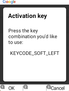

Old problem, but maybe someone can help me:
I’m trying to configure the physical activation key in the Voice Access settings. I’m able to open the menu and chose which button I’d like but it won’t save. On the E4610 I can press use Voice access itself to tap OK, or use scrcpy, but the problem is on this phone it shows the OK button as a physical Left Soft key press, so you cant just tap it.- that just remaps/selects that button as the tentative option to be mapped as the Voice Access activation key.

As I mentioned in my post, scrcpy also doesnt work.

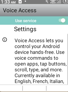

Thanks worked like a charm. No need to run any of those commands as you would on the exalt or classic. Just plug and play.
Install app, go to bussiness center click on voice access, turn it on after you have wifi or data. Then say open voice access settings. And while the voice access is running go to set up an activation button and say tap or touch ok to close and save your selection.

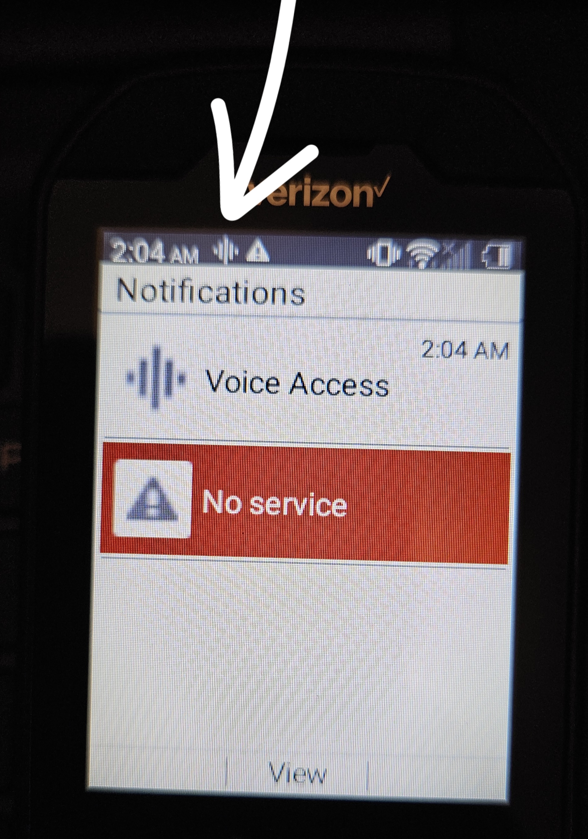

Though would be nice to get rid of this notification in the notification panel. And not having it show on top in the notification bar at all times.
Try running this command:
adb shell am start --user 0 -a android.settings.APP_NOTIFICATION_SETTINGS -e android.provider.extra.APP_PACKAGE INSERT YOUR APP NAME HERE
Or if you can get into the systems notification settings that would work also.
Thanks, worked great. Assuming you’re using @anonymousfliphones app
Here’s the full command to fire off. it brings you to the notification panel and I just toggled it off. Away with the annoying notifications.
./adb.exe shell am start --user 0 -a android.settings.APP_NOTIFICATION_SETTINGS -e android.provider.extra.APP_PACKAGE com.google.android.apps.accessibility.voiceaccest
